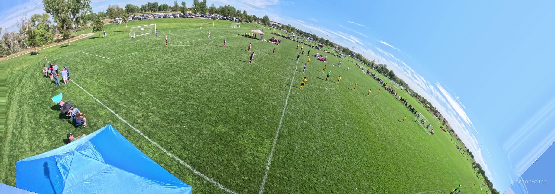

Bought the SeeUsPlay Rig since it looks pretty professional and like the sunshade and quick attach + battery accessories. There isn’t an option for my camera, so I selected the closest GoPro Hero 11 Black, but the output was terrible. Then tried Hero 10 Black, and got better results after adding a ton of manual stitches. However the stitched video is straight across. You can only see one part of the sideline. Is there something I need to do differently to be able to see both sidelines?
Main dashboard showing left and right portions (you can see entire sideline visible…)
Had to do a reply to show the stitched video screenshot:

I tried the calibration file from that thread and it stitches better I think (not sure if it resets my manual stitching). However, I can’t get it to show the right sideline. On Windows I can get it to barely show the right sideline, but on Mac, it doesn’t show the right sideline at all. As you can see in the screenshot below, it heavily favors the left sideline. How do I get it to be more balanced? The following link I did a video for calibration (just in case it is needed), as well as a shortened clip of the game in case it is needed to try and reproduce the stitching:
Nevermind! Found it. “Level the scene”. Sorry I missed that in the docs. That worked.
