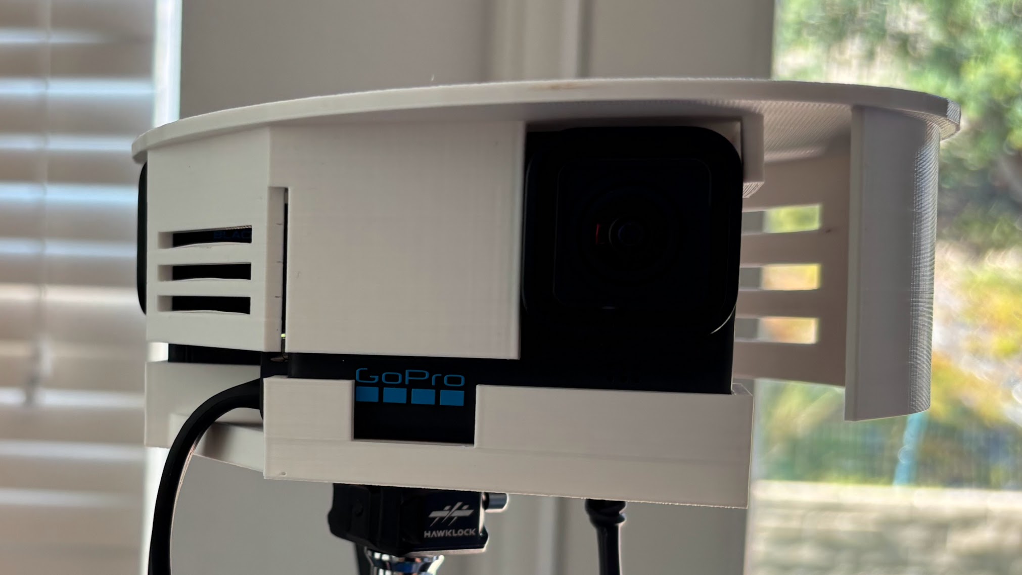

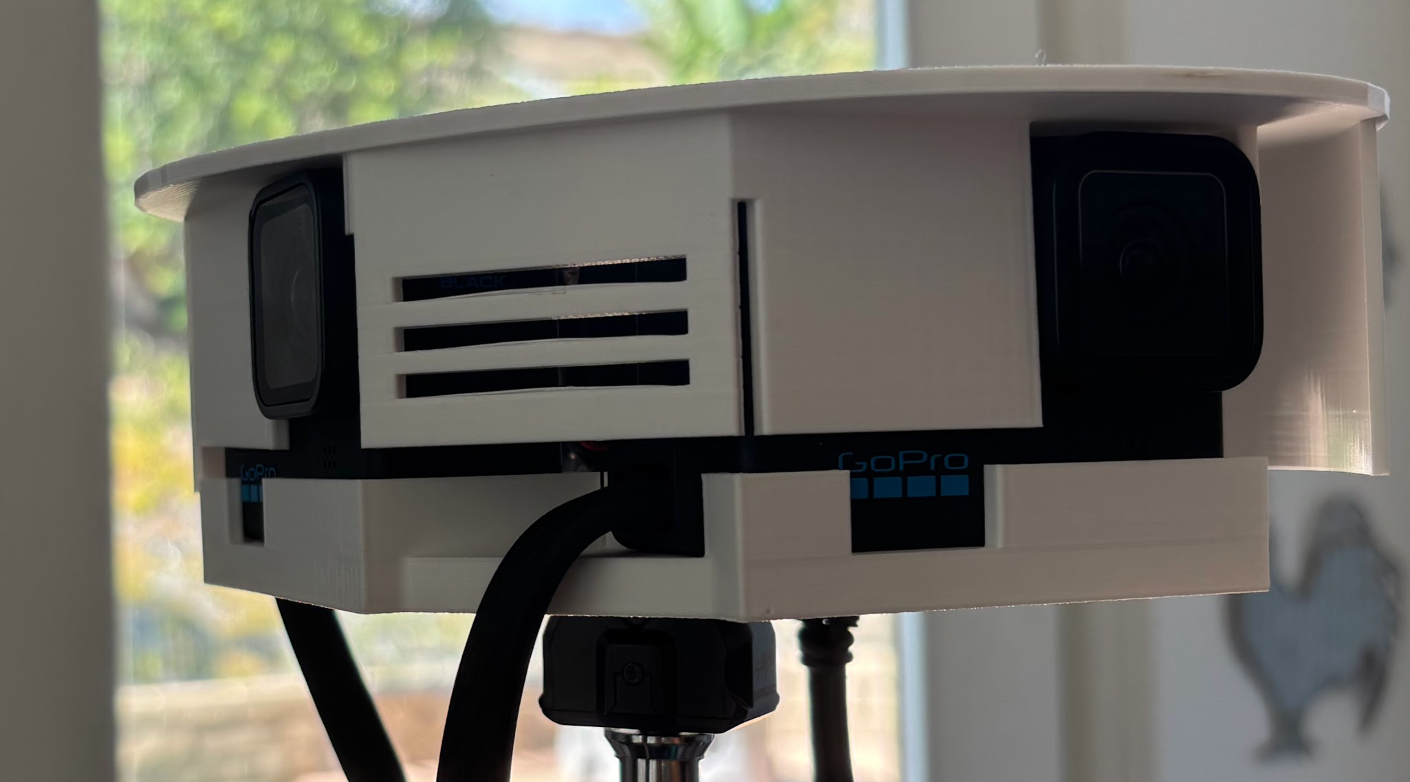

Just sharing my summer project::
Dual Gopro 12 - External Battery - Triple Fan cooling
A big thanks to Gchen for His (Her?) awesome and inspiring work :slightly_smiling_face:

Cam1
Hi.
This looks really impressive. What have you done for sound?
Would you share some more details on your project? Would you share your 3D model?
Thanks
Thank you :slight_smile:

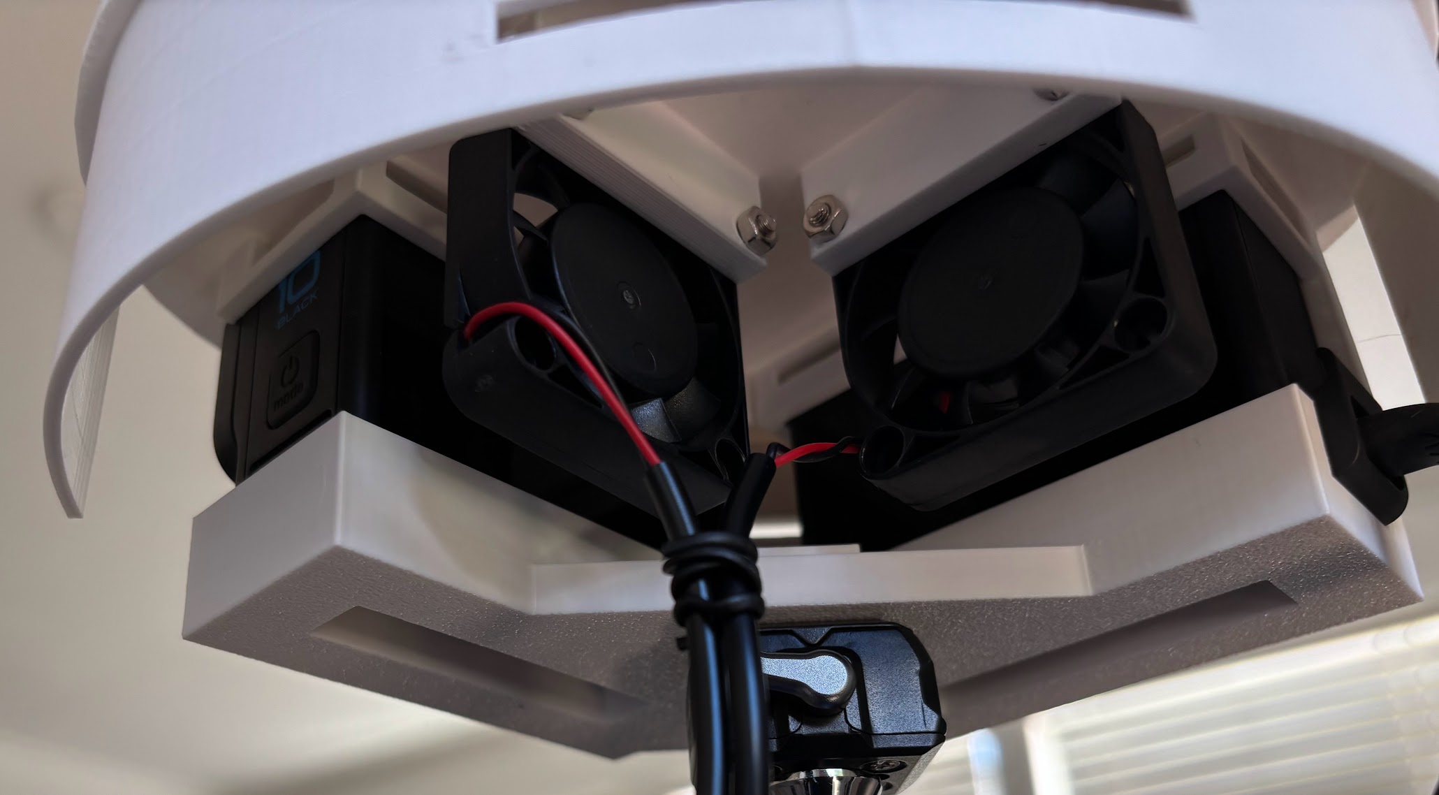

  • There’s no audible noise from the fans - they run slow thanks to a speed controller inside the frame
  • In addition to the top fan, two very small fans are replacing the gopro batteries - they act as heat exchanger, forcing fresh air in a hot air out
  • For easy access, the sd cards are placed outside the gopro via a microsd flat cable, they’re accessible from the top of the frame
  • The frame is mounted on a 3.2m Manfrotto tripod - it’s high enough to record basketball games
  • I created this at work to showcase our rapid prototyping skills to a potential customer. However, my boss prefers that I don’t share the CAD design - sorry about that

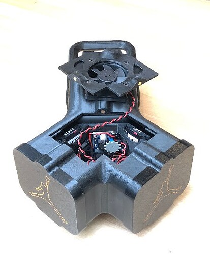

Just wanted to share this design. It’s not as awesome looking as the OPs but it gets the job done. Recorded 5 hours straight in 90+ degree heat without overheating using 2 small fans from amazon ($10). Everything is powered by an Anker Solix portable battery.
It’s my very first 3D printed design so a little rough around the edges. I remixed the original mount to include vent holes underneath as I noticed the GoPros (in my case, the Hero 10) would get really hot underneath, and the original mount would not allow this heat to dissipate. This is printed in PETG as I tried PLA but it warped in the heat.
Hi, what you mind sharing the file?
Would love the STL files for this!
Here you go, this is an updated V3 version. Print it in PETG in a light color like white, PLA will warp in the sun.
You recorded 5 hours straight in 90+ degrees without overheating on batteries? What model GoPro and settings did you use?
I have the Hero 10 cameras. You can’t use the internal batteries, those will overheat. I use the battery doors with passthrough usb cables and those are connected to a power bank.
