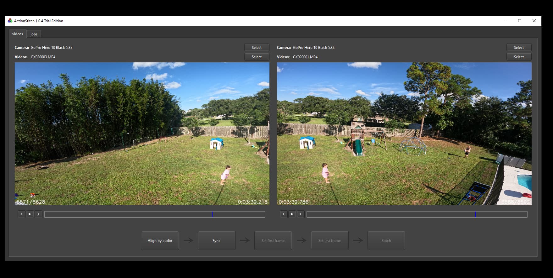

This is how my sync screen looks.

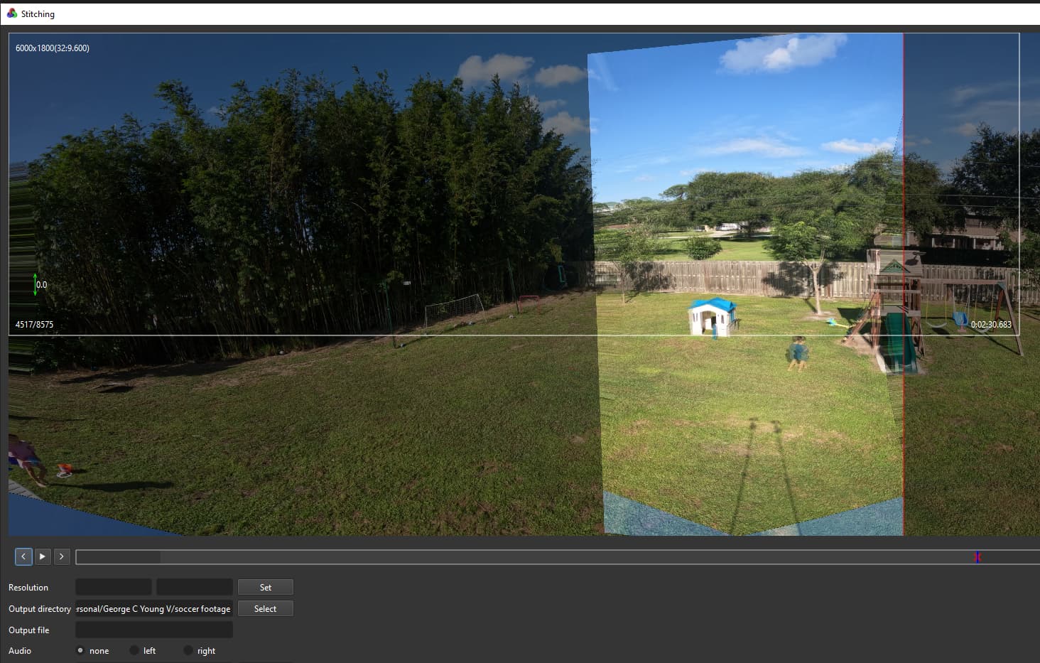

This is how my stitch screen looks.

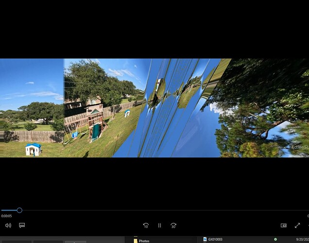

This is the result.
I followed the guide up to the stitching part, then I just hoped for the best (hoping it was just a visual glitch). I updated my video card driver. I’m up to date in Windows 10. Please help.

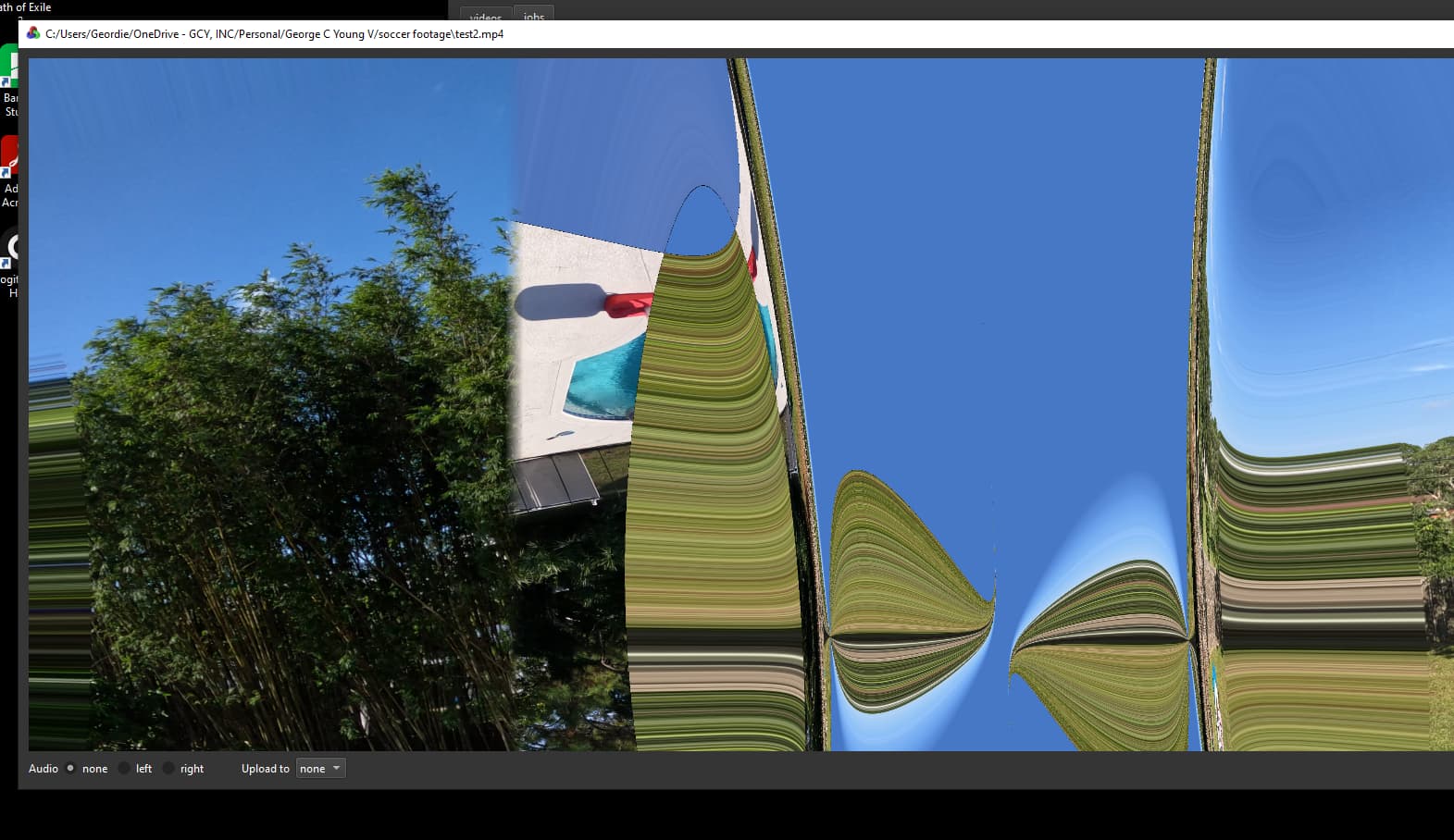

Nope. Don’t know why it looks that way there. Here’s another screenshot from another attempt.

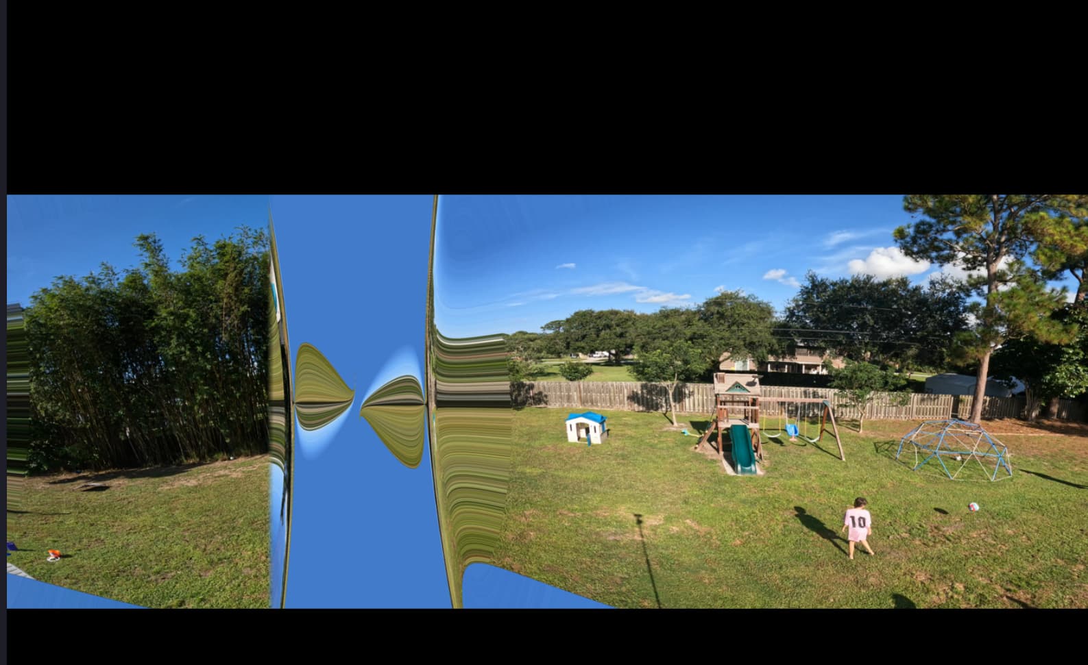

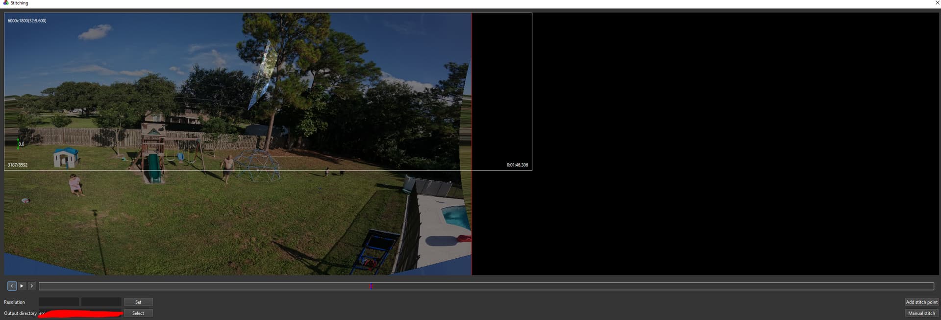

I’m seeing distortion in all attempts. This is the screen with stitching in progress.
This is the cleanest I’ve gotten. The left camera’s footages is perfectly clean prior to stitching.
I can take a look if you upload the videos to swisstransfer.com and PM me the link.
I can stitch your videos together, although the stitching isn’t perfect. That is because your videos were recorded in Super View mode, not Wide mode for which the calibration was done. The strange distortion you saw was likely caused by the separator (the red vertical line) not being positioned properly in the middle.
