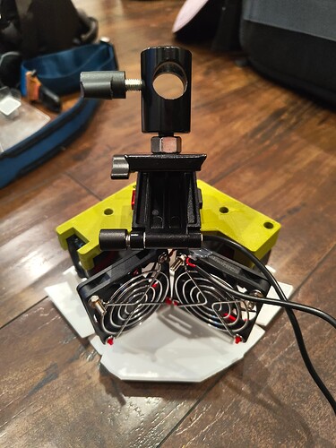

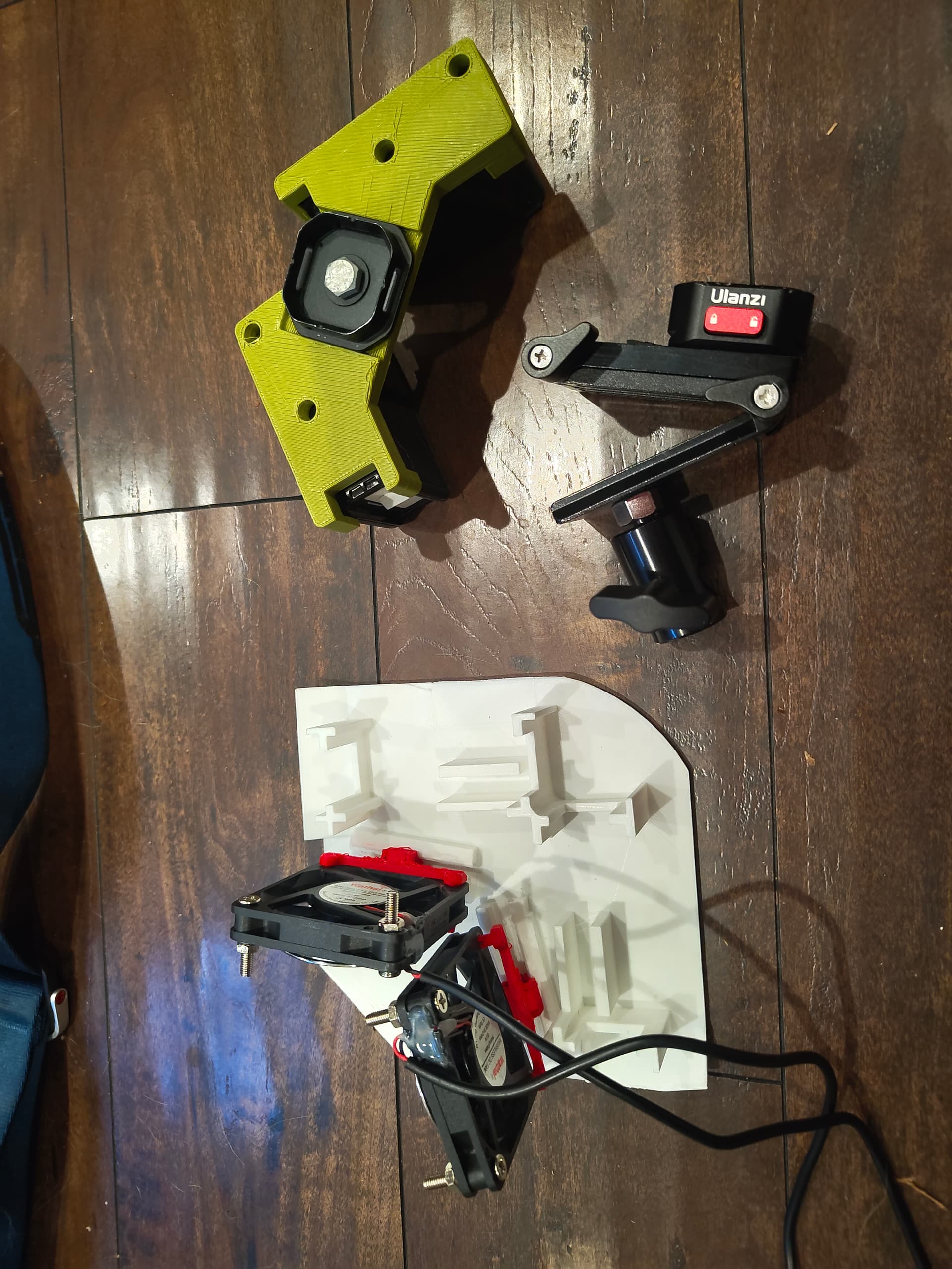

Are you just looking for a photo of it put together or? I’ve actually updated my setup to where the fans are hooked up to the sunshade that goes on the top instead of being on a tray behind the cameras. It makes setup easier and faster. My power bank is not included in the tray it hangs off of the tripod in a baggie.

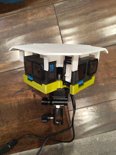

This is what my rig looks like with the two GoPro 11s. The GoPros overheat much faster than the Gamsod cameras did but with this setup I’ve been able to run it in 95 plus degree weather for full 90 minute games.
Looks good mate. Any chance you could please share the Gopro 11 shade STL?
