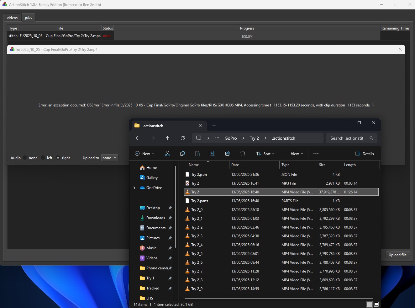

Hi. Processed two GoPro 11 videos which made it to 100%, but then returned an error. See below screenshot. Looks like the app combined the stitched video OK (called ‘Try 2’), but it has no audio. Is the file corrupt? An audio issue? Thanks.
Hi. I re-ran the stitching process but this time used the left audio option and it worked fine. Perhaps an issue with the right audio?
I have had that happen before but was never able to pinpoint the cause. In my case, I relaunch Action Stitch and restart the job from the jobs tab. @gchen can speak to the specifics but I believe that the software stores the job parameters in a file in the temp directory, and stores chunks of the stitched video there as well. In my experience it has been able to use these to complete the job without reprocessing the entire thing after some smaller amount of time to validate? the files.
