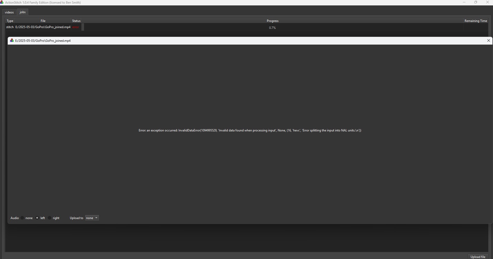

Error message InvalidDataError 1094995529 at 0.7%
Today I recorded a football game using the 2 GoPro 11s. Stitching gets to 0.7% then returns an error message (InvalidDataError 1094995529). Its happened twice now both at 0.7%. Please advice what I need to do. Screenshot shown below. Using version 1.04. Thanks
One video is corrupted at the 0.7% mark. Did you use the raw videos from GoPro?
Thanks. mp4 files, not RAW. I went through the videos individually on VLC player and noticed a glitch (a few frames froze then carried on as normal) in the first RHS camera video segment. The glitch is before kick off so I removed that footage from the LHS and RHS segments (using losslesscut), then ran stitching as normal and it worked fine. Hopefully this might help others who experience a similar issue.
