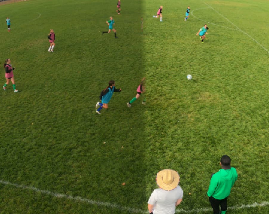

Any idea why players are disappearing/reappearing at the center line? I tried to manually sync the videos, but no luck. I tried to manually stitch too with 6-8 stitch points with the same results.

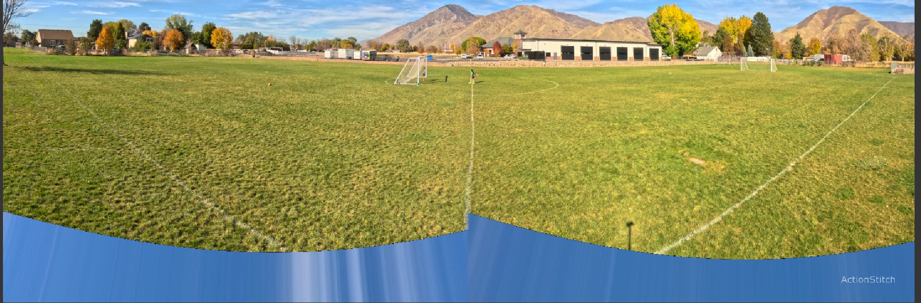

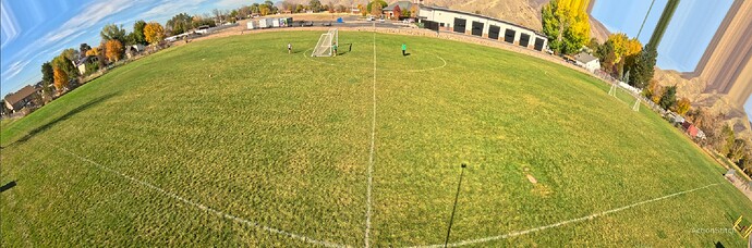

@gchen I tested out my new Go Pro 13’s using the existing calibration file that your team previously created. Do you think I am having a calibration issue? I tested two mounts: 3D print from your STL, and the SeeUsPlay rig.
5.3K/30
16:9
Wide
HyperSmooth off
8-Bit High
White Balance 5500K
Sharpness Low
3D Printed Mount Distortion at the bottom
SeeUsPlay Rig The field looks great but the clouds are blurry

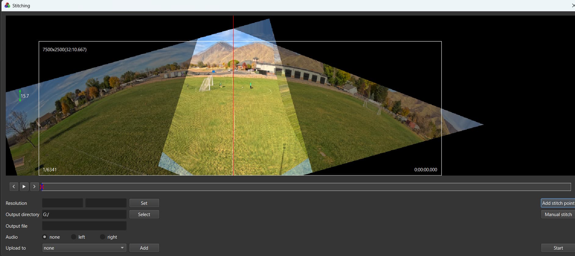

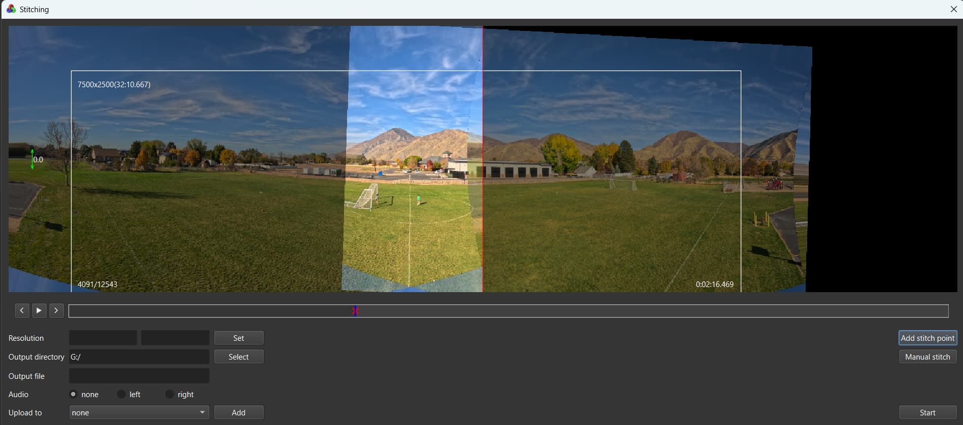

@kteeeee stitching looks good to me in these images, but the best way to determine if its is correct is to check the stitching dialog (https://actionstitch.com/img/screenshot_stitch.png). The overlapping area should appear clean and sharp. If it is blurry and even has a double image, that means the stitching is off.
Here is the stitching dialog screen for both setups. The SUP rig does have some blurry and double image issues in the kick off circle, so it might be a calibration issue.
SeeUsPlay Stitching Dialog screen
3D Print Stitching Dialog screen
