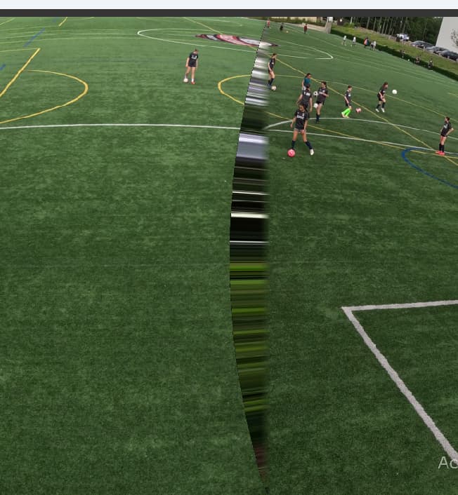

Also, anyone know about this blurred arc and how to get rid of it?
Move the red line to the left of this blurred arc. This line is the “dividing” line: pixels to the left of this line are taken from the left camera and pixels to the right are taken from the right camera. The blurred arc is an edge artifact of the left camera.
That did the trick - thank you, and also for this great software!
