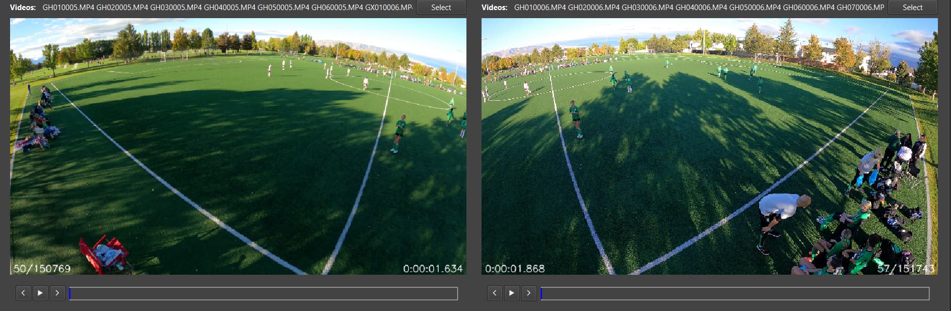

Hi all - I am testing the demo version out today for the first time and have run into some issues. My setup: two GoPro 9’s set at 4k/30, 8 bit rate, stabilization off, and mounted on a SeeUsPlay rig.
  1. I don’t see the GoPro 9 listed in the main menu. What should I select, or is there a GoPro 9 file I can import?

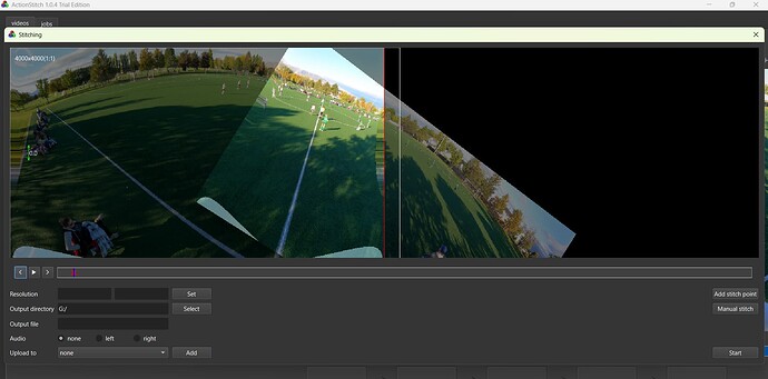

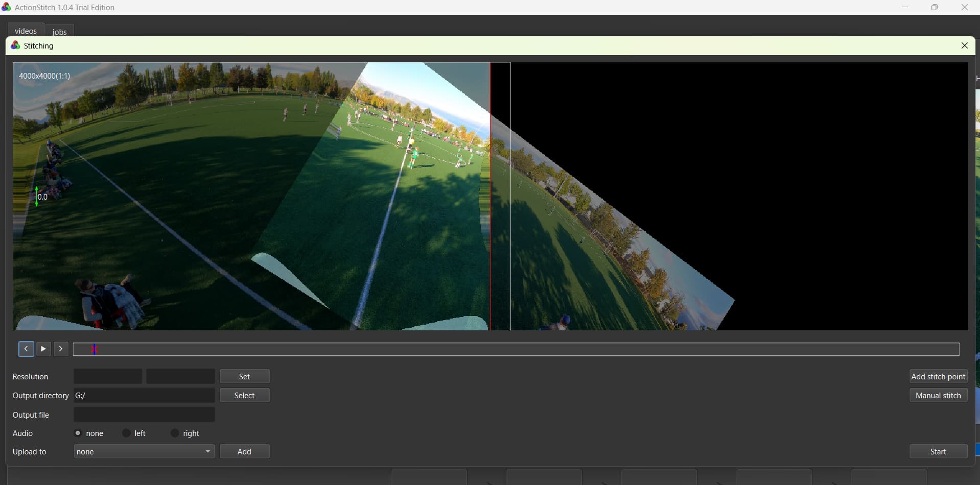

  2. Once I get to the stitching window, the video is tilted. How do I fix this?

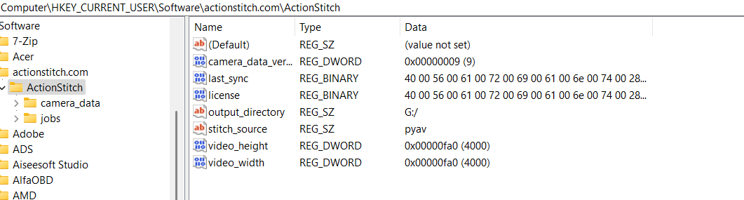

  3. I got the failed to read error but was able to update the registry key.

If the video is tilted you need to hold the green up and down arrow and move the mouse to rotate the entired stitched scene.
@gchen I did download the calibration file, and I have it selected under the camera option. At first, I thought recording in 4K was the issue as I saw your other comments about it needing to be 5K. I took a sample shot this morning in 5K, and I am still having the same issue. Is there a way for me to send you the videos to see if there is something I am doing wrong? I am printing a GoPro specific mount in case it is the SeeUsPlay rig that is causing the issue.

I sent two different videos: one 4k, and one 5k from the Go Pro 9. Thank you.

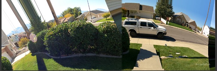

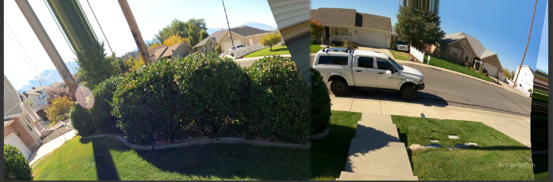

It can be stitched. The stitching isn’t perfect, because the SeeUsPlay rig is different – 2 cameras don’t sit on the same plane. If you use the mount recommended in our camera guide the results should be much better.

  2. Were the videos tilted for you and required rotating? Is that a SeeUsPlay rig issue?
  3. It’s usually the right side that is tilted. Is it possible to only rotate one side?
