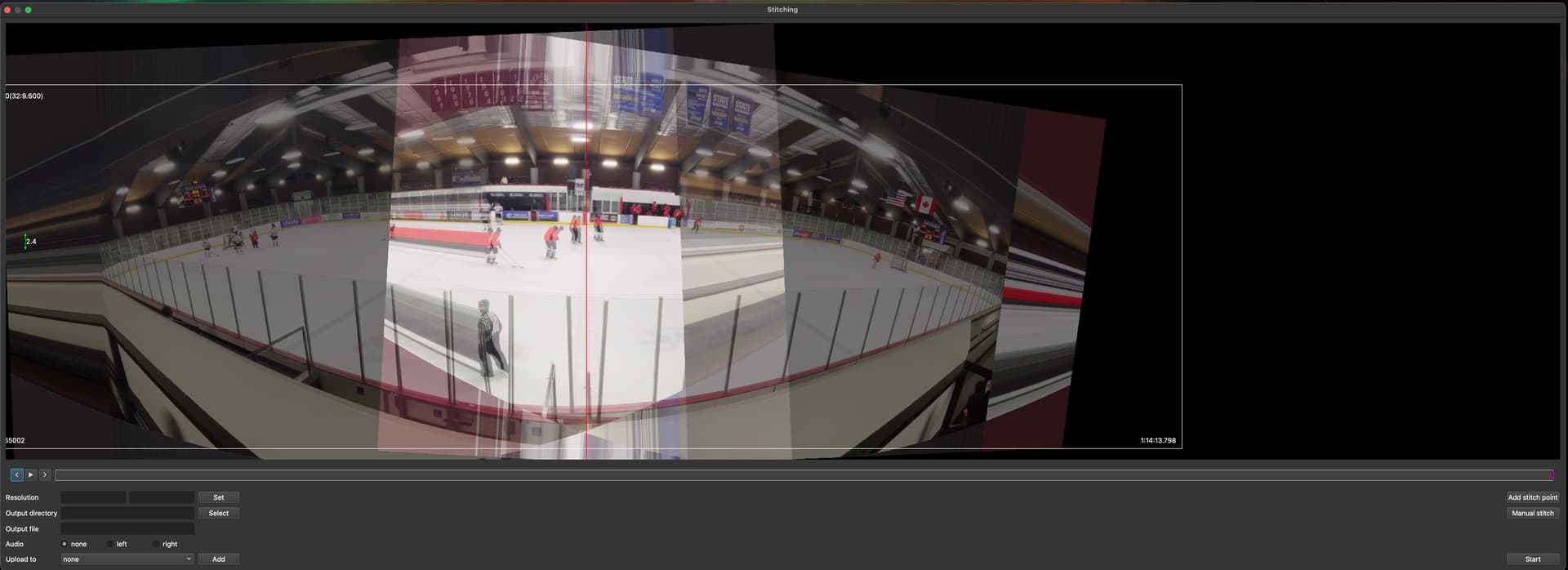

Thank you! - This is how the stitch came out - it’s almost there.
I tried with around 9 stitch points as well but still get overlap/ghosting distortion.
Should I try recording another calibration video?

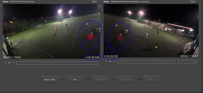

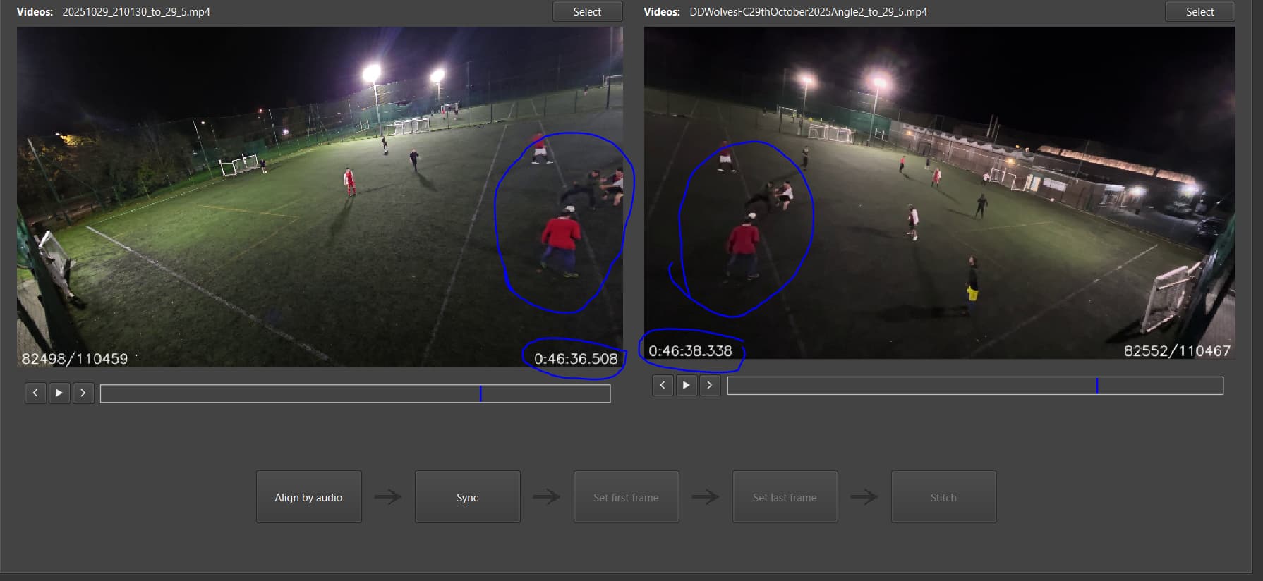

On the first screen I mean before stitch, set the correct time and stop the video and try to catch same person or stuff are on the both camera angle. And after that click stitch button. Repeat it till you catch good stitch point.
And please make sure your both video synced identically. Change time frames till both videos have been synced. See below screen shot as example.

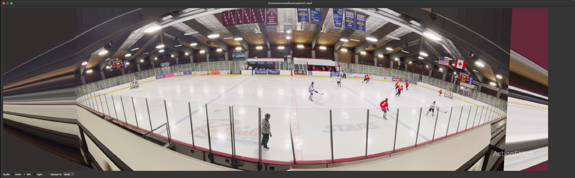

So I just went ahead and started the export even though the stitch looked off and it looks good enough for me! (There is some minor ghosting in the center of the game but it’s honestly fine for me)
I used the calibration file from both of you and they both had a decent export. Since an ice hockey sheet is a lot smaller than a football pitch I think the distorted outsides are expected. Below is what seems to be exported.
