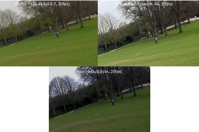

Sharing in case of interest to others. Some images of my sons football shirt (!) taken using a GoPro 11, iPhone 14 and a Reolink camera. To me, the iPhone image is slightly better quality than the GoPro.

Hi aela111. Not satisfied. Main issue is the 20fps limit, the video is also over rendered if the camera moves in the wind. However, the focal distance can be set at a greater distance than GoPro, therefore players further away from the camera are clearer compared to GoPro. I can send you a few examples if you PM me.

The issue I had with the Reolink Duo 3 was that the field and players were washed out and fuzzy. Spectators on the other side of the field were clear though. I think between the bright sun and movement of the players the camera processing couldn’t keep up. Returned that thing quickly.
