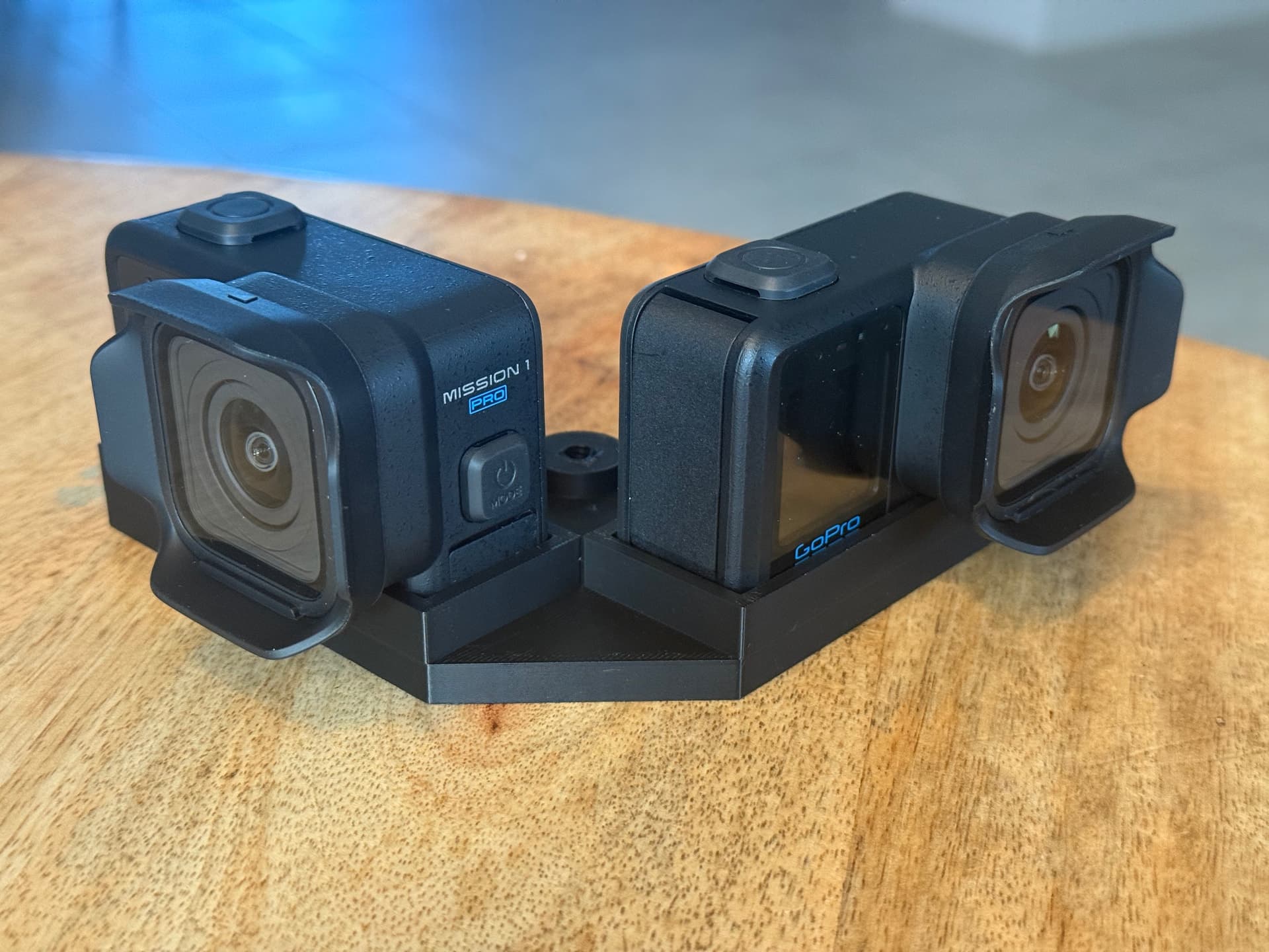

I have two mission 1 pro cameras. I will get a calibration video soon to send out. You need active cooling if you do 8K 60 FPS. They overheat in ~30 minutes in 90 degree ambient. I created a simple mount without tilt since I have a tilt adapter. I’m going to build an active cooling box that will allow external power. Recording in 4K 60 fps will be ideal for low light scenarios as the sensor is really good in 4K mode in tough lighting scenarios.
I uploaded to Maker World if you have a Bambu Labs printer https://makerworld.com/en/models/2948176-gopro-mission-1-pro-dual-mount-actionstitch#profileId-3302847
STL: https://drive.google.com/file/d/1CS3NnqI-jA_j5yt77vVe3p5MiMYRrXjc/view?usp=share_link
